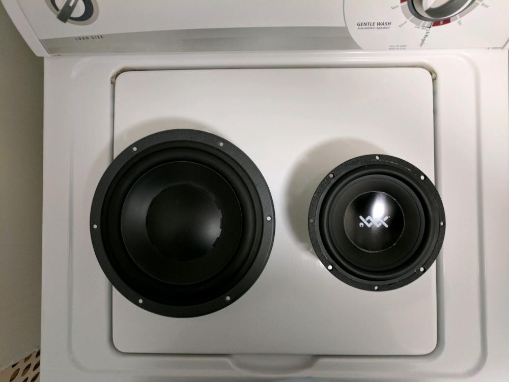

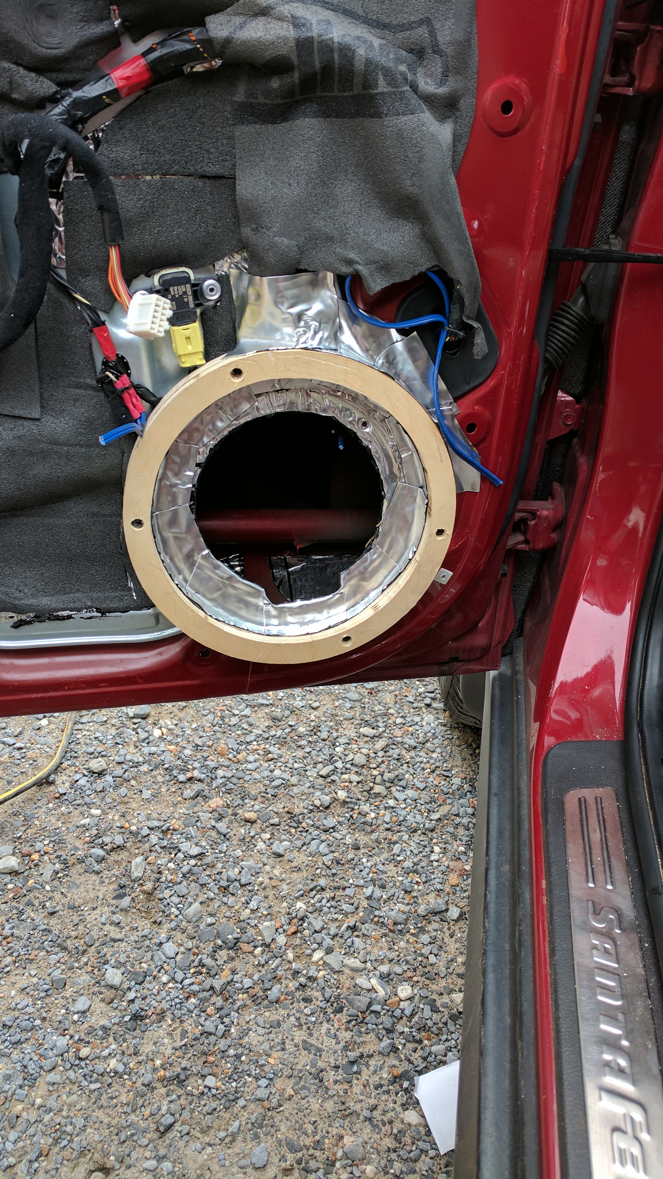

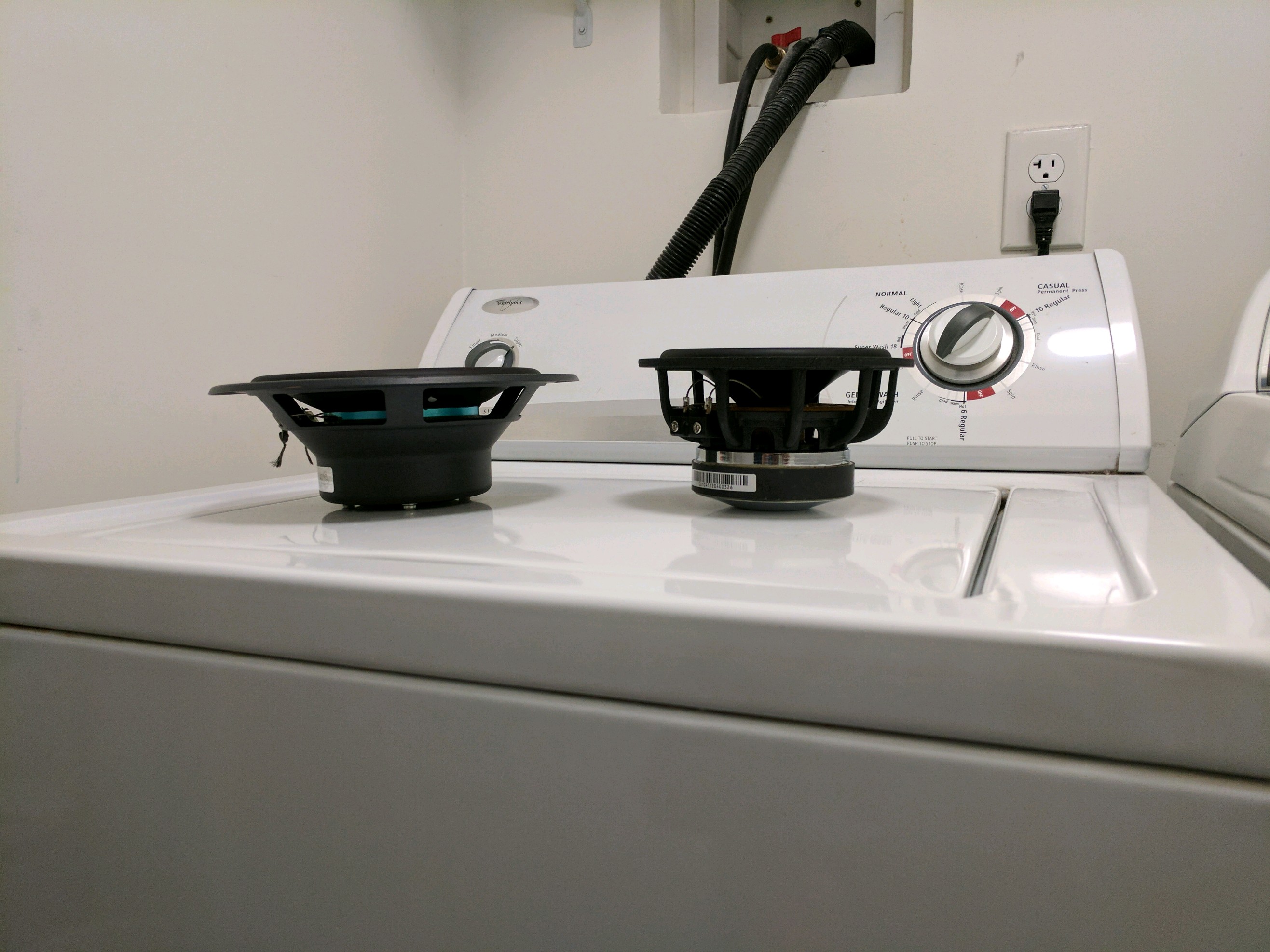

Thanks! Yeah Hyundai definitely left some room to work with. OEM was 6.5's, no real metal cutting except for a small gap to ensure speaker terminals never touch any metal.
I had some RE XXX 6.5"s, which were 3.25" deep! These Dynaudio's only 3" deep. The diameter had me a little worried, but it all actually fit. A tight fit, but it worked!

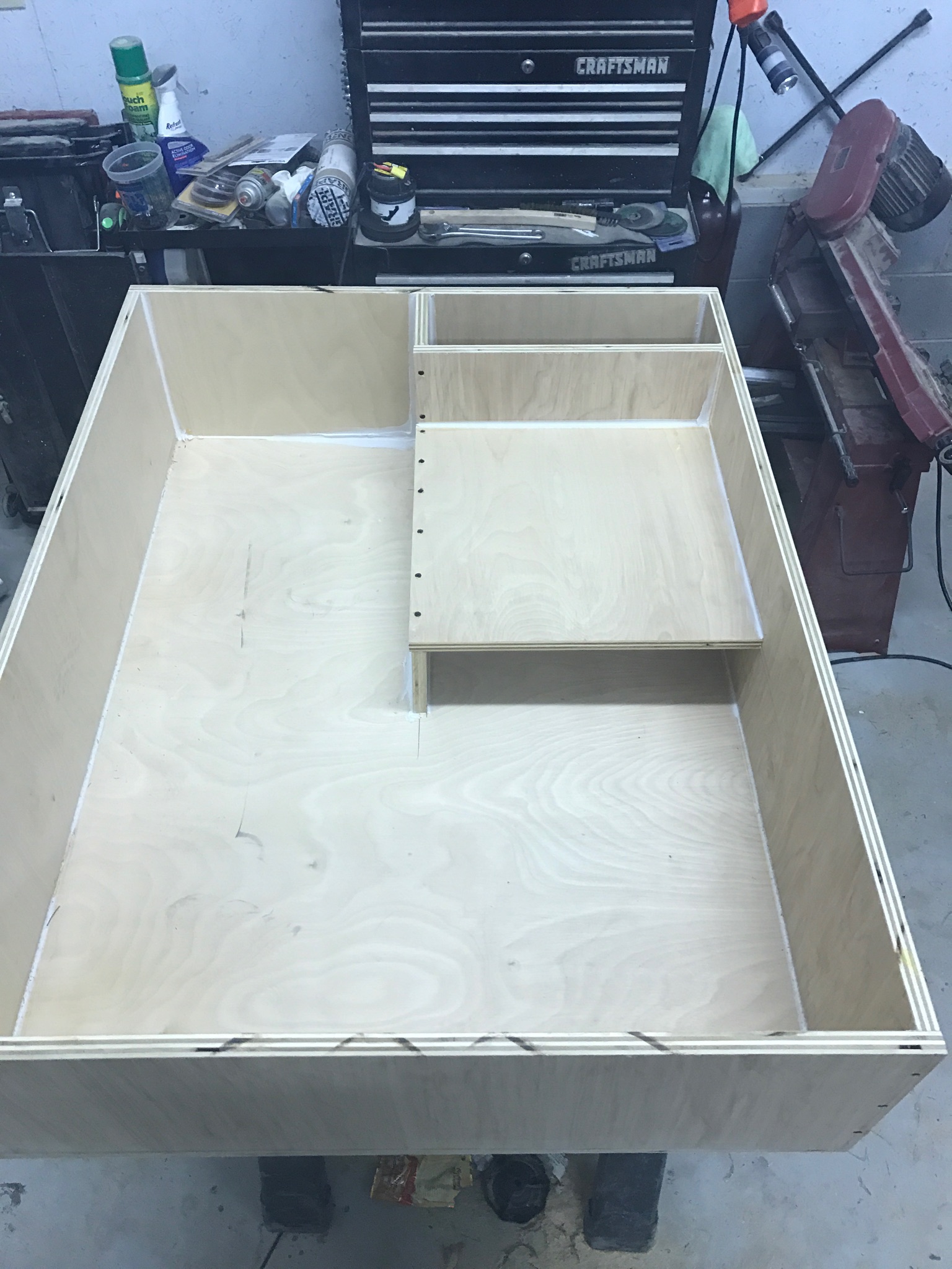

all credit goes to Alex (WhereAmEye? on DIYMA) for the awesome A-pillars and David Berger for the sub enclosure and rewiring of the system.
