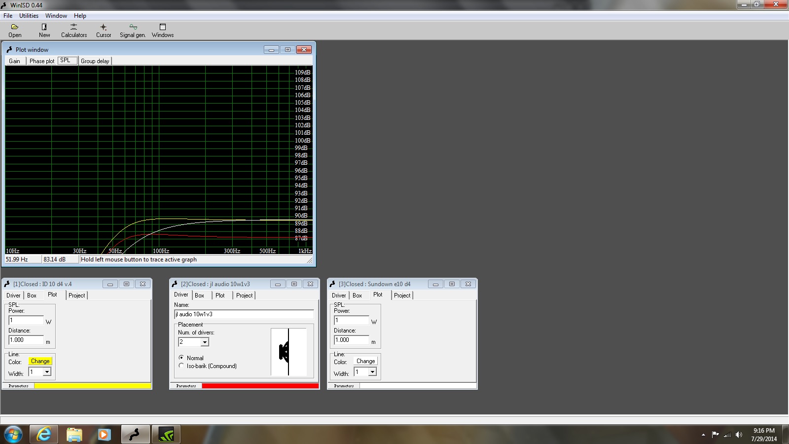

Well here they are modeled.  I used one sub per and 150 watts.  Box size based on my .63 minus displacements roughly from my memory.

Why aren't you modeling them in their boxes? Don't use that power and distance stuff.
Click the box tab and just put in the airspace. Then post another pic.
Actually you probably put in the box specs. Just put the power back down to 1 watt
When I did 1 watt all it changed was the db level. The freq response was exactly the same. Do you want the gain tab showing or what?
Also they are in .58 boxes roughly.

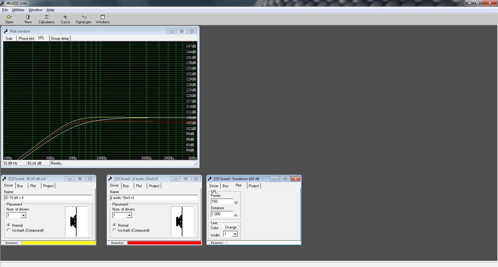

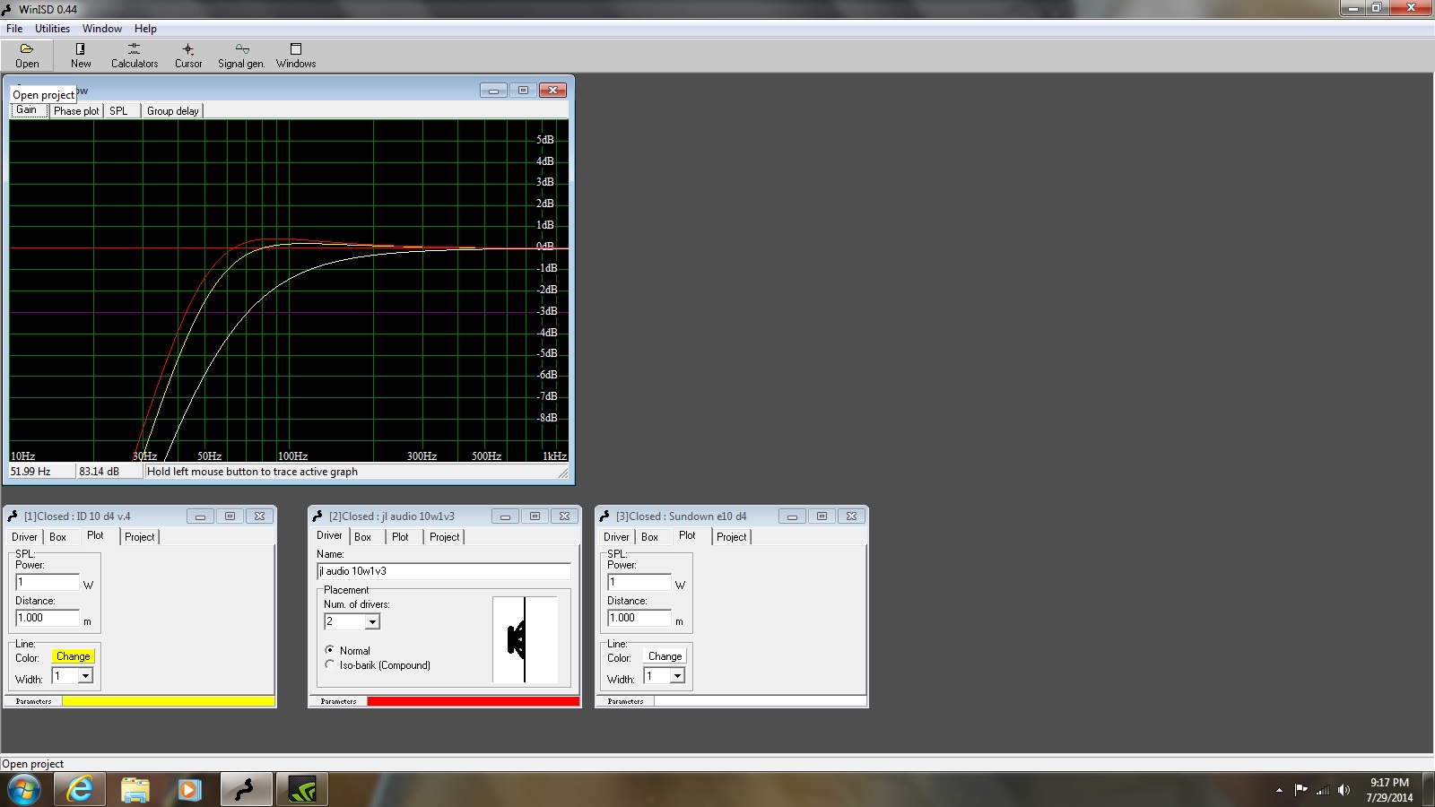

Here is the model with 2 subs in boxes about the right size with 1 watt of power the gain and spl tab.
