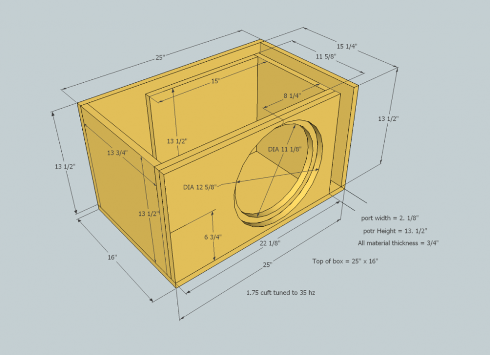

From looking at your power and tuning frequency, I would shoot for a 1.75 cuft tuned to 30 Hz. If you need help with a design just let me know.
I've built several sa12 boxes for myself.
It's all a matter of preference but I found tuning to 35hz to work really well. Changing from 30 to 35hz I gained quite a bit of loudness and hits the 45-60hz range much better and very little change in low 30 to high 20hz output. I can tell a slight difference in the low lows but the output and bandwidth I gained everywhere else more than made up for it.
Also being that you want to put well over rated power you may want to go a little smaller on volume.

No problem, I will work on a design for you. I think 35 Hz is a good tuning frequency as mentioned above, let me know if that would be good or what tuning frequency you prefer.
If you think 35 hz is good, sure, I will go with that.
Ok 35 Hz it is, will work on it.
Yo, check out my SA-12 box while you are waiting for your design. :)

The 45's not necessary, not much of a an audible difference. Wire it to 1 ohm ( too much work to re-wire lol ), set the gain appropriately and play it normally until you feel confident to crank it up bit by bit.
I am a bit pressed on time or I would have done it in metric (cm), you can convert the measurements, a little bit off would not matter. Good luck on the build, you are welcome !

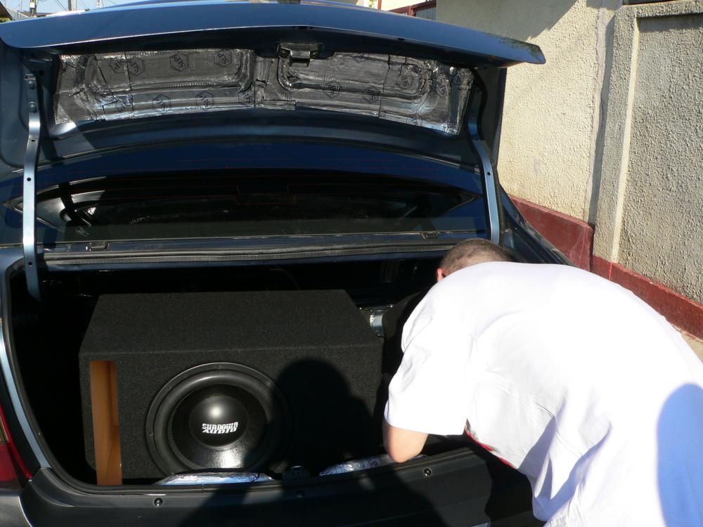

The box is done, as I promised I have return with some pics. The old sealed box, made by me... as I said before, not to good looking but it gets the job done. About the new box, what can I say, it get quite loud, and I'm sure it's gonna get louder when I'm gonna put the sub at 1 ohm. Great box and hope to be back soon with a video.

It was a fun box,great output, change it after a while, but as friends said, that was the crazy box i had.
Only one major drawback, it had a slightly port noise, if you have a hatchback maybe you can hear it. If I open the trunk I can hear it, in the car sounded great. Maybe it can be fixed with a bigger port area.
Haha. I designed that box when I was a young designer , and yes, with that amount of power it should have had a bit more port area.
