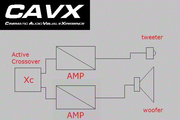

Powering speakers active means that the signal coming out of the amplifier is already crossed over (signal is divided for the speaker being used). So this means that the speaker you are powering is directly wired to the amplifier without a crossover in between the two. Some people buy amplifiers that have the crossover circuitry in the amplifier. Other people buy separate crossovers or signal processors that divide the signal then the signal goes to the amplifier. When running active you can choose to use speakers from multiple manufactuers and an assortment of other options are available that you do not have with a passive system.
Speaker selection and crossover frequency points can be difficult when running active. Using a passive component set can be easy and for most people they are very pleased. For your first setup of this multitude running a passive soundstage would probably be your best bet :)
