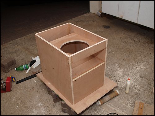

1. I've almost finished my POC#2 project - a "small" (4.3 cu.ft. net) 40Hz tapped horn based around a cheap pro audio driver (Fs 39 Hz, Qts=0.31). I haven't put up a page about it yet, but a picture of it under construction can be seen here: http://www.diysubwoofers.org/projects/other/PA310-TH/images/PA310-TH-10.jpg . HornResp predicts efficiency of 93dB@ 40 Hz /1W/1M, over 96dB/1W/1M through the passband, and an upper cutoff above 120 Hz. The design is theoretically displacement-limited to 116dB peak @90W just about 50 Hz in its passband though (and that's assuming that I can use the full 5mm throw of the driver - hardly likely). I can glean a few more dB by going with a slightly larger horn, but if I had access to an inexpensive driver with similar specs and a bit more Xmax...

A higher Q will require an adjustment in the horn's geometry to compensate. After having run dozens of TH sims in HornResp, it looks like generally a higher Q = lower throat/mouth ratio to achieve a flat passband. A reduction in Vas might reduce overall size, but this and the change in throat/mouth ratio may not necessarily be good things - the end result might be a sim that looks great - until it's time to actually fit the driver into the box :).
