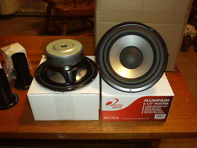

but here's the start of the bookshelf speakers for my boy's room....
i'll be using memphis mclass crossovers for now...
but anyway..onto the pics...
the box and what's inside...

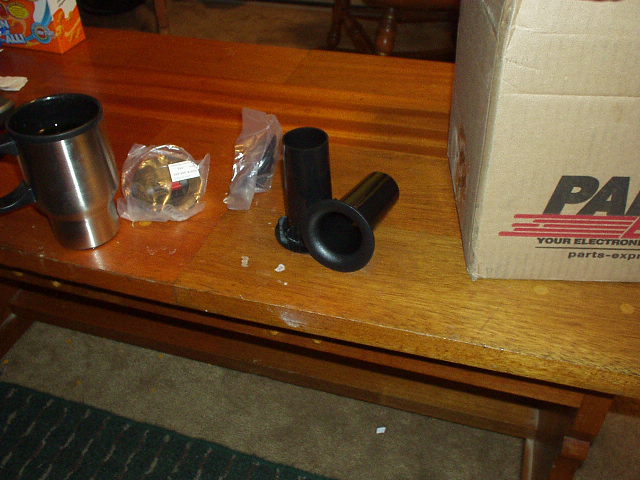

1.5" flared port tubes....yep, gotta go vented!!
textile dome tweeters..for that warm, fuzzy sound...lol

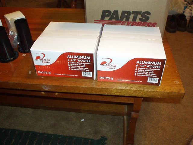

what?? more boxes??? :banhim:
6.5 (or 7, whichever) alum cone mid/subs......
can u say wheeeeeeeeeeeeee??

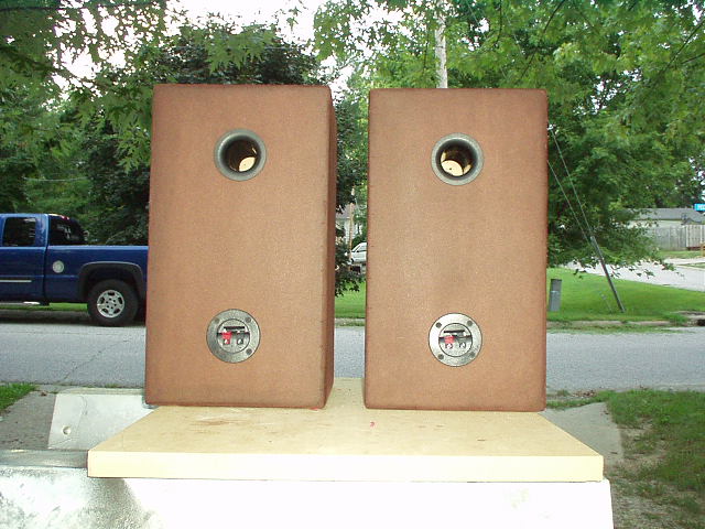

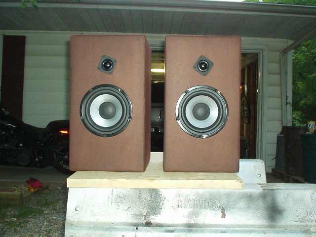

and here's the finished product!!!
they are 2db louder then the OEM pos's according to my RS meter. same songs, same mic location....i even did it with one of the new speakers sitting on the floor!!!
anyway, on with the show....

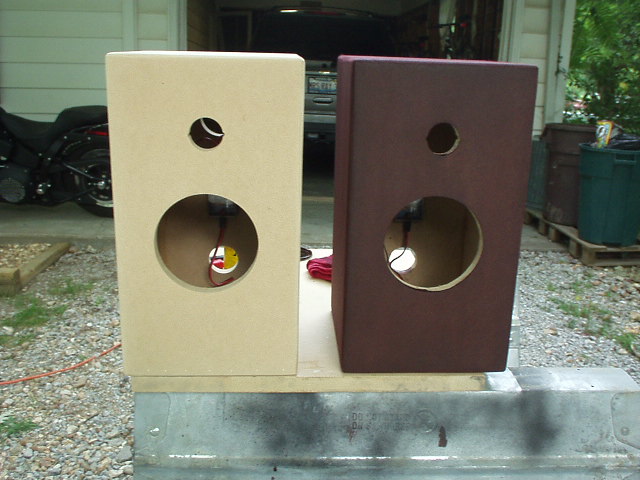

one stained, one not..from the front and back....red mahagony stain (he likes it)

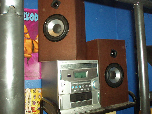

everything installed....

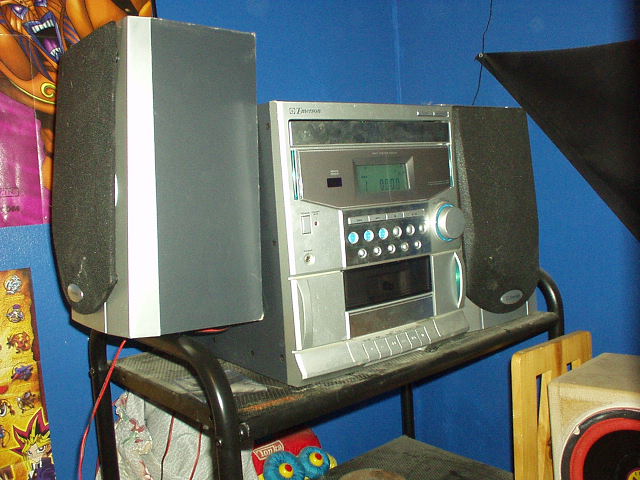

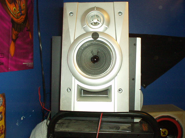

what he had.....
old vs new...and the new setup...
while the new is head and shoulders better then the old, his radio sucks balls. so that will get replaced soon...

yeah, i do...even freeair, they had a tremendous amount of bass for what they are and the power they were getting!
his radio just introduces way too much distortion, regardless of speaker used....i'm going to hook them up to the pioneer tomorrow just to listen to them some more!
btw, those are ~.66ft^3 enclosures, tuned to ~40hz...it's a great combination!

also, i have no clue if the setup is correct..lol...but after reading over at ditaudio, i decided teh port should be directly behind the tweeter,with the tweet and mid inline and about 6" from center to center. it sounds better darn good, but i have yet to really listen to it...

I've found that rear-firing ports have better midrange dispersion...and you can get better in-room gains by corner loading them. Same thing goes for PR's, too.
Share this post
Link to post
Share on other sites
cool...i'll have to try corner loading them.....about how far away should i put them from the corner?
wheeeeeeeeeeeeeeeeeeeeeeeeeeeeeeeeeeeeeee :slayer:
Share this post
Link to post
experiment...usually a few inches is good.

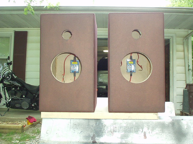

Are those Xovers optimized at all for the speakers, or did you sort of kludge that together? :domoslay: :ph34r:
Share this post
Link to post
they are actually memphis mclass 4x6 xovers...
i don't have a clue where to start on designing/building my own. so i threw this big memphis bandaid in there for now...

pic showing the xovers...look into the boxes..u'll see them...lol..

The tweeter is crooked.
That CD player is weak, those speakers are probably getting a good 20-30W, if that.
i wanted the tweeter crooked..
the cd player is weak...going to buy him a new one...and it's rated 25wrms @ 4ohm....but i doubt it..lol..
