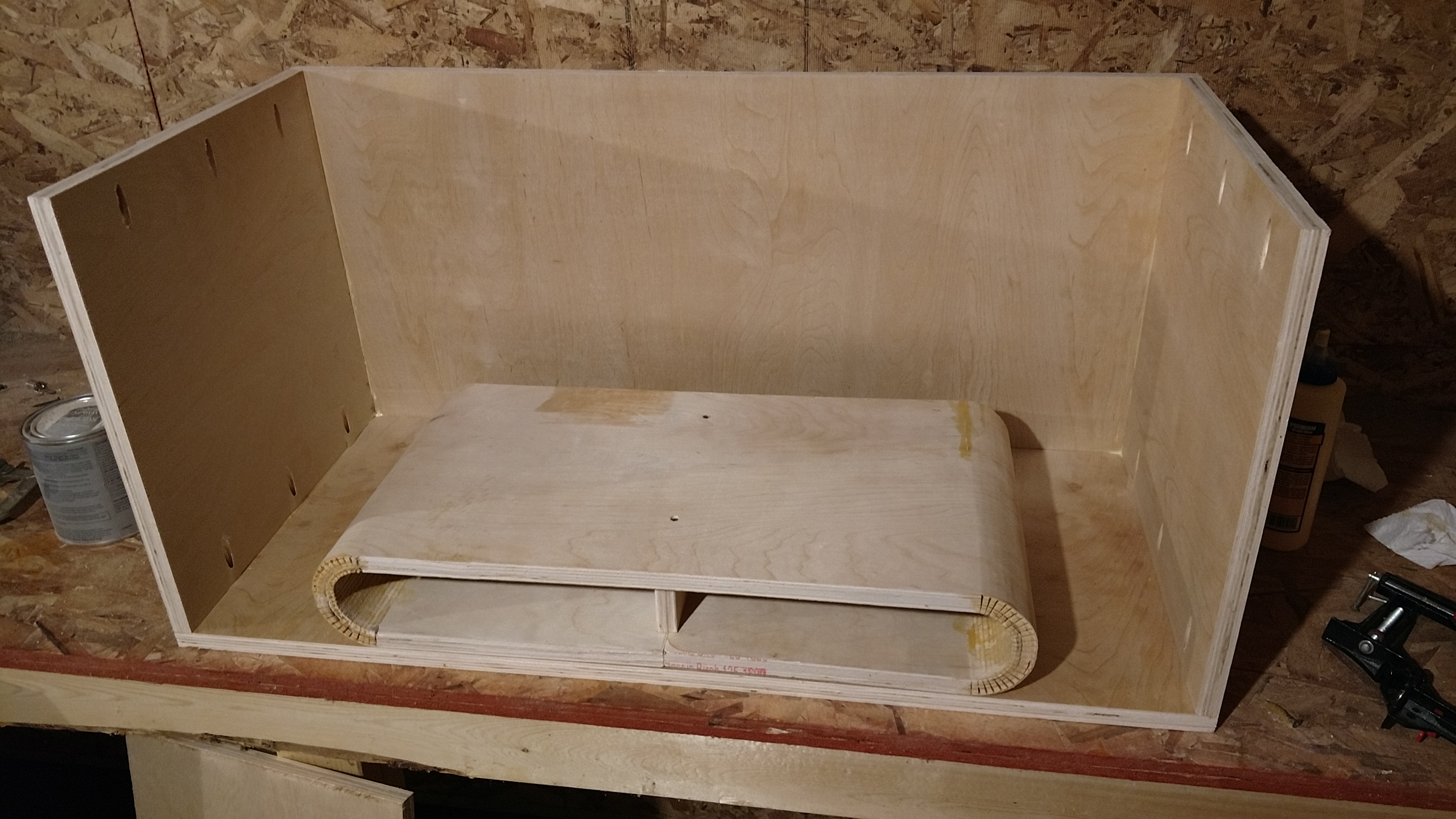

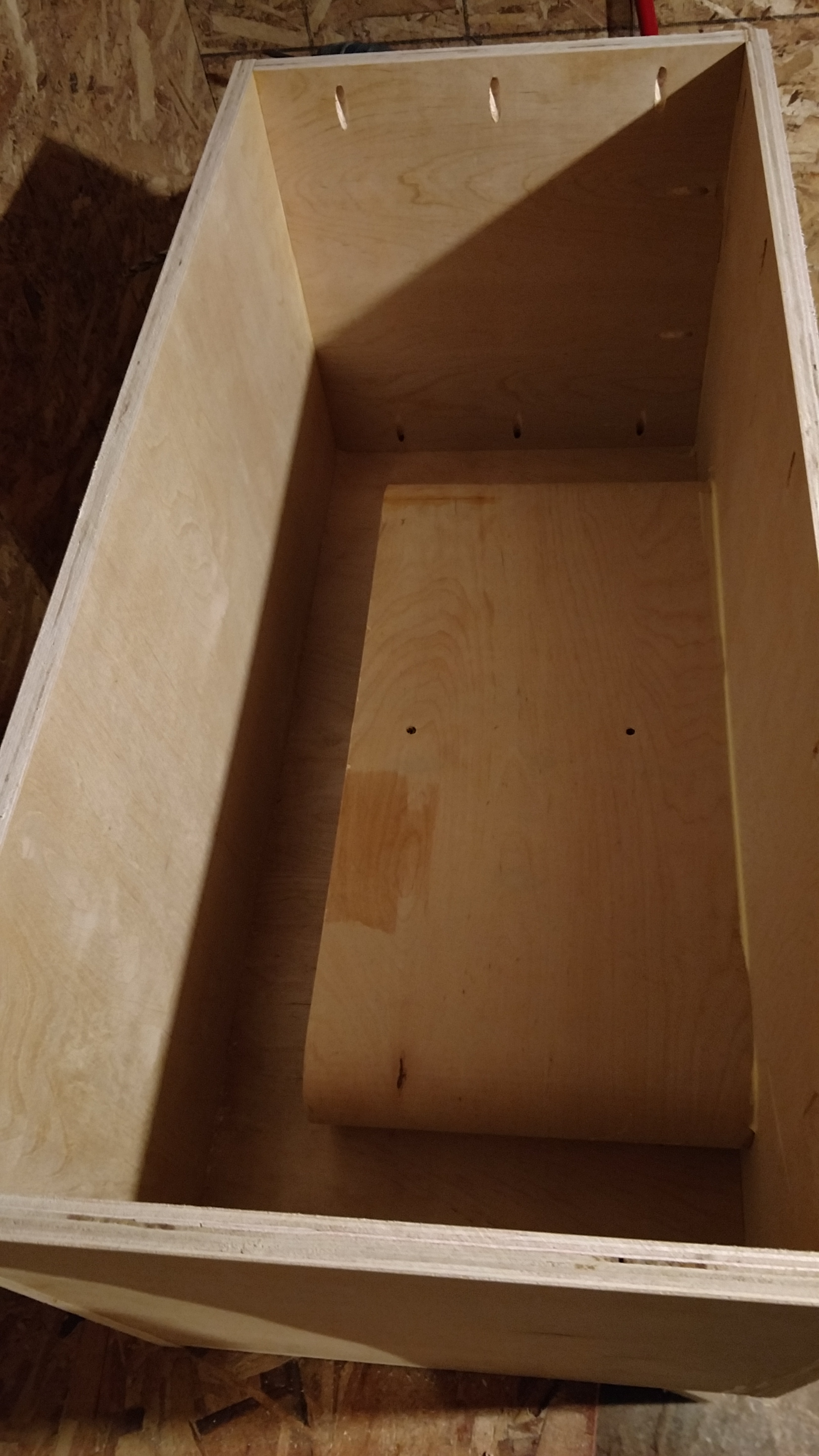

Just out curiosity, what had you imagined? There are 6 screws attached it to the floor of the enclosure (from the bottom up), and pocket holes that attach it to the front of the box.

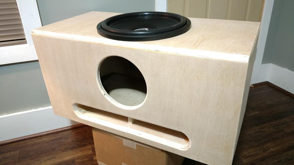

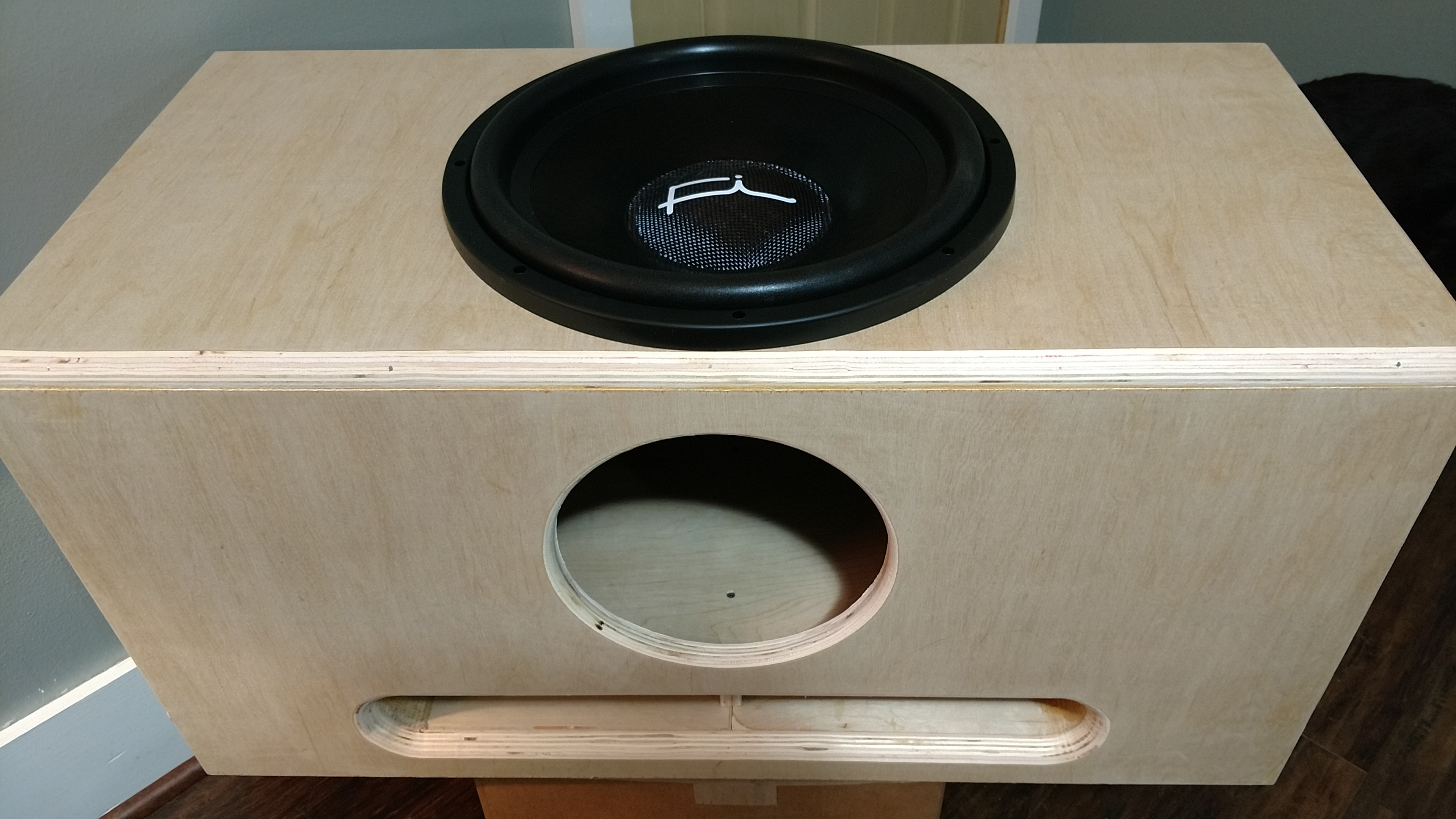

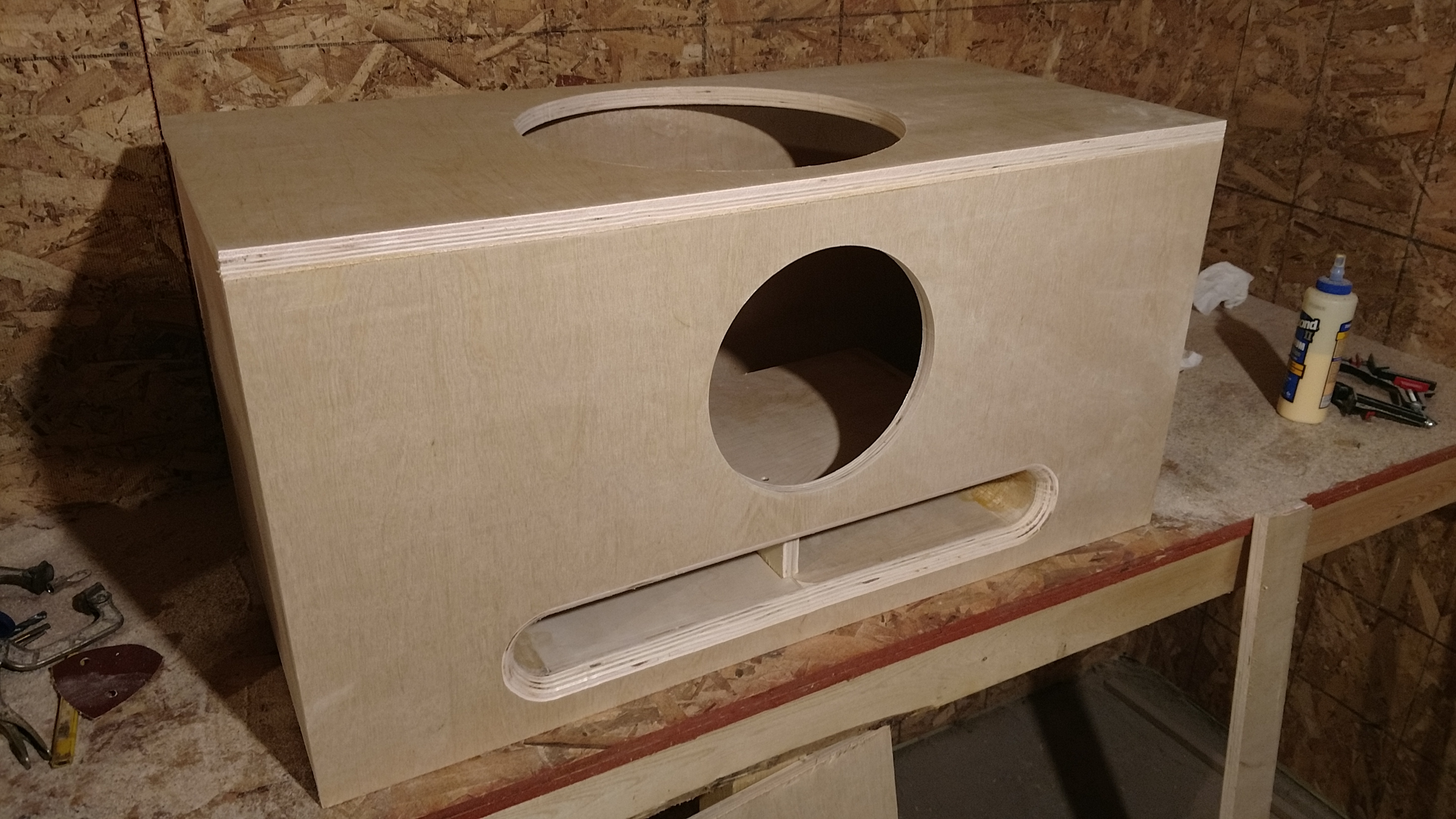

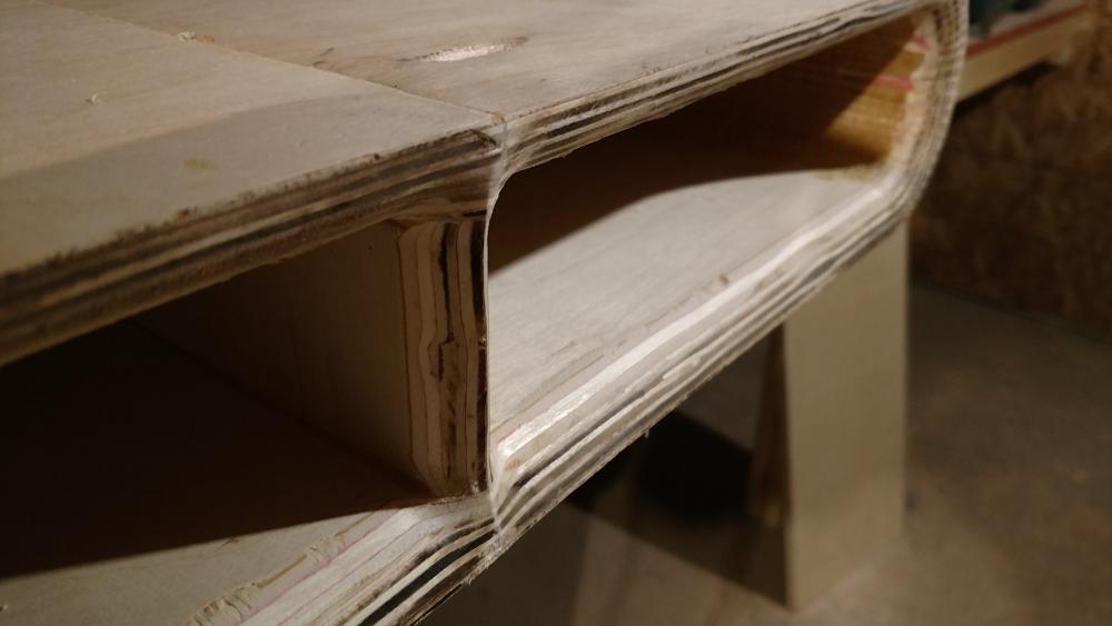

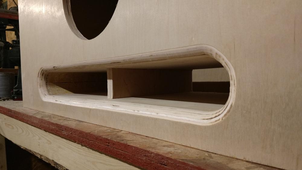

Well, final construction is done. Just going to let the glue cure overnight before I flush trim the back side, but then she'll be ready for some orange dye and polyurethane! I'm extremely happy with how the box has turned out (especially the port). Oh, and the 9" hole in the front is the viewing window. Everyone does square/rectangular windows, so I wanted to do something different. Also need to buy some LED's to put inside the box. I can't decide whether I want to paint the inside white, or just poly it and leave it a natural finish. Suggestions?

Correct. That is just the port. 2.5" tall, 21" wide, and 13" long.
