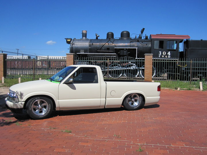

97'chevy s10 bagged. not low enough due to inners still inside the engine bay. the truck is bagged on Thorbecke brothers 3 link with a behind and under the axle bag kit, the front is bagged with thorbecke brothers upper and lower tubular control arms with upper bag cups and a little shop of horrors bump steer linkage kit that replaces the whole front steering components. for air management the truck has 8 1/2 SMC valves with 1/2 DOT airline. connected to a 8 gallon air tank with 2 viair 480C compressors feeding the air supply. truck rides on Slam RE-7's for the rear and airlift 2B7 bags in the front(soon to change out for some Slam re-6's, truck also has a autopage car alarm, a optima red top battery, and a crappy 2.2L that will soon be changed out for a 5.3L/6.0L LSX/ T-56 swap
