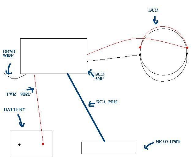

Ok, so I recently purchased a Dual 1 version of the Fi BL 15'' along with a custom box and a Kicker zx1500.1 I also bought a 5000 watt wiring kit by audiopipe. When i wired everything up, (as shown in the crudly drawn pics) it hardly works. When i turn it up to 18 (max volume is 34, and preffered volume is 26) it shuts off. but it doesn't stay off, if i turn the volume back down it comes right back on. and sometimes it will try to hit @ 18. and hits everyother beat. All in all it doesn't sound good ...at all. I want to know if i wired something wrong, or ...something... idk i just want it fixed! :(
http://img.photobucket.com/albums/v172/don...ringdiagram.jpg
http://img.photobucket.com/albums/v172/don...rudedrawing.jpg
i tried it both ways, one w/ my comp speakers and one without, both did the same thing :(

That amp is 2 ohm stable from what I understand. You have your sub wired + to + and - to -, which means your dual 1 sub is running at 1/2 an ohm on a 2ohm stable amp.
If you run a + wire from your amp to one terminal on the sub, and a - from the amp to the - terminal, then connect the remaining + and - terminal with a short piece of wire you'll be running that sub at 2 ohms, which is correct for that amp.
That should fix it for you, unless I'm misreading your sketch. Best of luck.

Dual 1 ohm? Yes that would cause it to do things like that if its not rated for that load. Hook it up in series; into one coil then to the other and back to the amp like he said. I don't know anyone using one yet, didn't even think of it being dual 1 ohm.

x3 on the .5ohm wiring as I'm sure your amp won't support that load and is going into protect. Wire it up in series for a 2ohm load per the diagram above.
